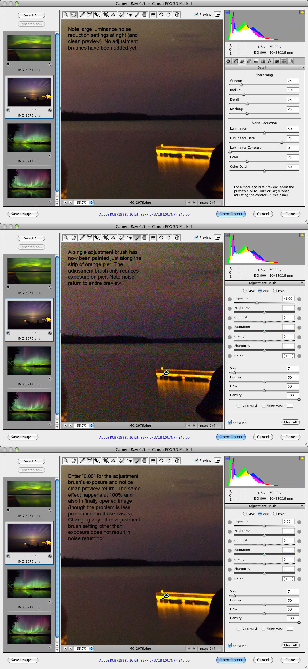

Hello,
I just noticed the following problem:
1) Camera Raw 6.5; Bridge CS5 (4.0.5.11); Mac OS X 10.6.8; Mac Pro 3,1; Dual Quad-Core Xeon; 8GB RAM.
2) Start with a noisy raw file (mine is from a Canon 5D II).
3) Apply Noise Reduction (Luminance:30; Lum Detail:75; Lum Contrast:0; Color:25; Color Detail:50).
4) Go to Adjustment Brush and set a non-zero Exposure value.
5) Apply brush to image and notice the Noise Reduction effects disappear (noise returns).
6) Click Clear All button to clear Adjustment Brush and Noise Reduction works again.
This seems to only happen with Adjustment Brushes with a non-zero Exposure value (applying brightness or other settings don't seem to produce the problem).
Anyone else seeing this?
Thanks!

    There are some known issues with the local exposure adjustment leading to global changes in image appearance, notably in the highlights.  The issue with noise should already be fixed with the ACR 6.6 release candidate (RC), currently available.

    The issue Tom describes continues to happen with my raw files.  I convert Canon cr2 files to DNG on import.  If I use the graduated filter or adjustment brush in Camera Raw to make exposure adjustments, noise reduction is cancelled in the preview unless I am adjusting a slider.  In other words, while I am physically moving a slider, noise reduction is applied, but when I release the slider, noise reduction is cancelled, although it is again applied when I save the image to jpeg.  This makes it extremely difficult to work on high ISO images. I have updated to ACR 6.6.  That did not help.  Any suggestions?
    Mark as:
  • Currently Being Moderated
    Dec 14, 2011 1:49 PM   in reply to d\'Huez
    For the purposes of evaluating noise reduction, the current solution is to zoom to 1:1.  NR will always be applied in that case, and it will be the most accurate rendition for the purposes of evaluating the quality of the NR.
    Eric
    Mark as:
    Dec 15, 2011 2:34 PM   in reply to MadManChan2000
    Thanks, Eric, but the issue is not evaluating noise reduction; the issue is working on other aspects of the image in other panels.  For instance, in the Basics panel, after I have used the adjustment brush or graduated filter, no noise reduction is applied unless I am adjusting a slider.  When I release the slider, noise reduction is cancelled.  This makes it very difficult to make basic adjustments such as exposure and contrast.  Why is noise reduction cancelled in the preview after using the adjustment brush or graduated filter?
