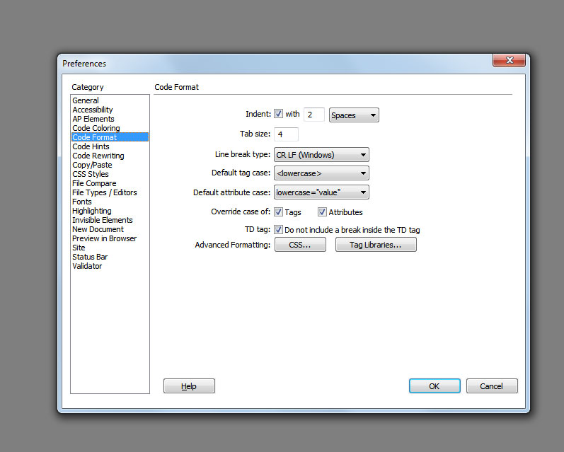

Have a screen shot - http://www.ospreygraphix.com/dreamweaver-bug.jpg
As you can see, the option doesn't exist. So when I press the shortcut to center or even the button in the CSS properties tab, it adds a Div Tag with an align=center attribute irreguardless of there being text selected or even present.

That option was available in older versions of DW. In CS6, deprecated tags have been removed.
If you want efficiency, use CSS properties to center your page. No special html code required. The whole point of CSS is to keep presentation styles separate from content making your HTML code leaner.
