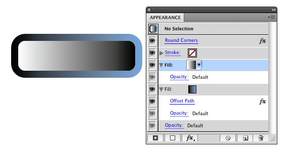

Monika Gause Apr 22, 2010 4:34 AM (in response to maheshwar26)To retain the radius you should apple the rounded corner by other means. Use a rectangle for a start and then add Effect > Stylize > Round corner.
You can't have a gradient in the stroke. Instead use the appearance panel to add a second fill under the existing fill. Apply Effect > Path > Offset Path (use the stroke width as the value there) and then apply a gradient to it

Maybe it will get clearer with this screenshot:
http://www.vektorgarten.de/img/tut/button-gradients.png
You can add fills with the button in the bottom of the palette or
using the palette's menu
