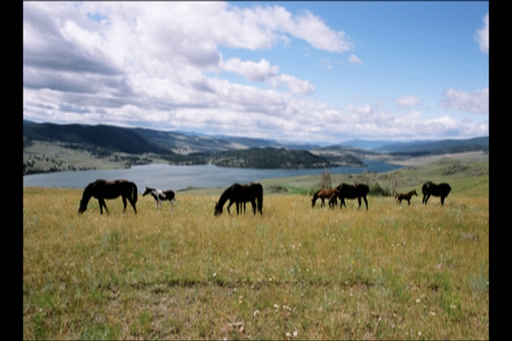

      I'm currently putting together a photo slideshow in Premiere and I've run into a bit of a problem. I re-sized all of the photos to 720x480 and for some reason when I export the file from premiere, the photos all have a rather large border even though I sized them to fit and inside the preview window of premiere, they fit the screen no problem.
      http://www.torquemod.com/slideshow_border.jpg
      The other problem is that the image quality is absolutely terrible regardless of the MBPS I set the exported file to. The current screen is from a 16Mbps mpeg2 export!
      I've tried exporting at several different aspect ratios, Square, 4:3 and 16:9 and none of them make a difference. Also, the images themselves are (mostly) importing at 0.9091 even when I change the aspect ratio inside Photoshop. Its like it won't adjust the aspect ratio, it just ignores any changes I make.
      I don't understand what I'm doing wrong.

            Well that's the thing. I figured using a desktop setting with a PAR of 1.0 would work so I tried this after I posted, but the images seem to have aspect ratios built into them somehow even though I've cropped them all to be exactly 720x480 in Photoshop so I thought the PAR would be at 1.0. MOST of them seem to read in premiere as an aspect ratio of .9091 but some of them do show as 1.0. and the ones that show as .9091 still have the bars
            How do I change the PAR if premiere seems to ignore the settings from Photoshop? I even tried deleting the PAR settings inside photoshop and changing them, but it didn't affect them at all once they went back into premiere.
            Everything is still images, not using any video. Also, there's still the problem with the loss of quality. They're perfectly clear as actual jpegs and inside Premiere they look fine but upon export they're fuzzy. Changing the sequence PAR to 1.0 fixed the borders but didn't improve quality at all.

                The project is going to be a 16:9 widescreen DVD. When I changed the sequence settings to Desktop and PAR 1.0 it fixed the border issue on any of the images that read as a PAR of 1.0 in premiere but some of the images are still reading as a PAR of 0.9091 and changing the PAR inside Photoshop doesn't seem to make a difference to Premiere.
                Most of the images were first re-sized to the nearest dimension in either height or width and THEN cropped in PS. The reason for this is they would often scale down to something like 723 x 480 and then I'd just adjust the canvas width to 720 to remove the extra pixels. The problem is the original image sizes are all different cause they weren't all taken with the same camera. Maybe what I need to do is cut and paste all of the photos into a clean canvas in PS and then save them as another file name to get them to be PAR 1.0 rather than saving over the original jpeg? Does Premiere look at XIF data at all?
                Basically my only remaining problems are the PAR (why some images are 1.0 and some aren't) and the clarity upon rendering. I render to Mpeg2 and it doesn't matter if I set the CBR to 6 or 16, they always look blurry.
