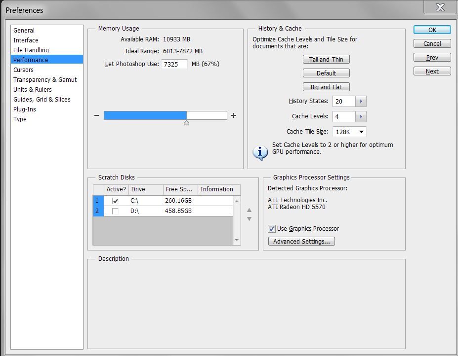

      These are my performance settings in CS6. I have tried switching the graphics processor on and off. It makes not difference at all. I have also tried switching off the GPU in SEP2 and that makes no difference either.

          I forgot the performace screen grab. Just added it.
