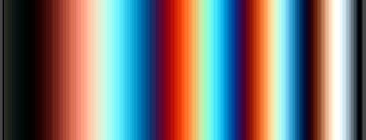

      Why is photoshop 14 drawing colors differently than 13 and is there any way to stop it?
      I have a 256 step, three channel wedge, made without dither or aliasing, which draws perfectly (no bands or crossover) in CS6.  This same file draws messed up in CC, with slight colors shifts and stepping. I have saved out the color settings from CS and loaded them in CC.  The individual channels draw the same in both files when viewed singly.
      While my monitor calibration has only been perfect this way on gamma 1.8 images (this is what I have my NEC spectraview software set to),  but it has been perfect, no steps, in both colormatch and gray gamma 1.8 from CS4 through CS6.  Now, comparing CC to CS, on the same monitor, same file, same settings, the channels draw identically but the color composite is different.
      The screen shot of the color composite file is shows 3/4 tone changes:
      http://www.ikonyc.com/CC_CS_bands.jpg
      The same file with a solar curve on it:
      http://www.ikonyc.com/CC_CS_bands_solar.jpg
      Channels draw as before, and match up, witness the screen shot of the channels lined up with a solar curve:
      http://www.ikonyc.com/CC_CS_channels.jpg
      I realize that this probably doesn't look bad in the context of a webbrowser, however, usless I've made some gross mistake, the rendering has changed and I see no documentation on it.

          Do you see the same issue when you set your Drawing Mode (in the Advanced GPU settings) to Basic and restart Photoshop?
          There are two places Photoshop can do color-managment transforms - in the GPU and in the CPU, and setting to Basic (or disabling GPU operation entirely) moves it into the CPU, which traditionally has had fewer problems.
          I'm pretty sure some work has been done in the area of GPU-based color-management in recent history.  Not everything Adobe has changed is documented.
          To this day (and going all the way back to at least CS5) I can reproduce a case where a smooth 16 bit gradient expressed in a document in the ProPhoto RGB color space will show up with banding and color.  It doesn't happen with all color spaces.  Notably ProPhoto RGB has the same gamma (1.8) as what you've mentioned.
          See this for more info:
          http://forums.adobe.com/thread/792332
          The test file I linked there is still online.
          I wonder if what you're seeing with your test document may be one and the same issue, but somehow having been triggered to show with your test dataset.  Any chance you've moved up from Basic GPU mode to Normal or Advanced coincident with seeing this?

            Basic or Off solves the color problem.  Turning OpenGL and OpenCL completely off cuts many features I reguarly use, so I'm setting it to basic.  All settings on Normal have the problem.  My previous configuration in CS was to advanced, so it is  a change in CC/14.
            Thank you very much.

                    FYI, in order to keep the file as perfect 256 steps, I'm not doing an conversions, just pasting channels and assigning profiles, and res'ing nearest neighbor.  The file has been assigned Colormatch.  If I reassign AbobeRGB and change my working space to Adobe in CS and CC, again, the composite color draws differently, while the channels draw perfectly (no stepping) and identically.  Strangely, if I add an alpha, mulitchannel, assign CMYK, they draw the same.  If I screen shoot on my secondary monitor, also running off the Radeon, on the file in Colormatch, again the RGB color composite is rendered differently in CS and CC.
                    There are tons of tests I could run on this, but I lost a day already thinking my monitor was messed.  Under all circumstances on my machine (BW/RGB/Lab/4C), the single channels draw fine with a 1.8 gamma setting on the NEC (but not on 20%, etc).
                    It is hard to come to any conclusion other than Adobe has decided to render gamma/color differently in RGB via OpenGL/CL above the basic setting.
