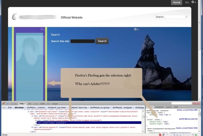

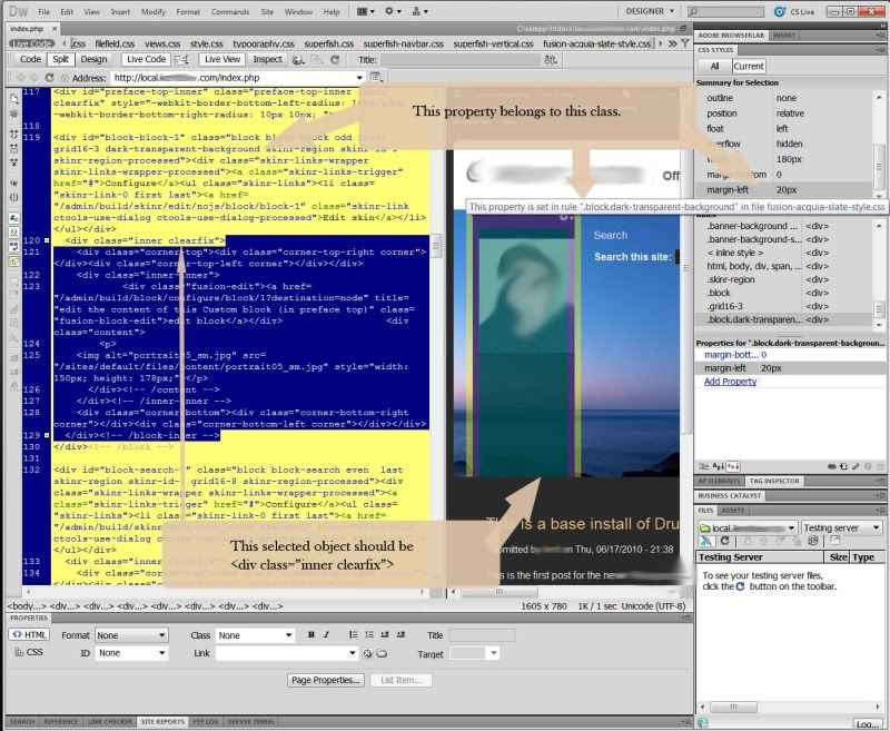

                My site is still in development, so it's not available on the www.  I hope you guys can fix this issue, because when it works properly, it will be great!
                Here are the screen grabs, which are better than nothing, I suppose.  If you would like to contact me directly, I would be more than happy to supply Adobe with the actual Drupal code so that you can reproduce the problem exactly.

                  uggh, I guess the forum has a max resolution limit.  The original images were much higher in resolution.
                  Here are direct links to the images:
                  http://i93.photobucket.com/albums/l56/zoon_unit/DW_Drupal_commented2.jpg
                  http://i93.photobucket.com/albums/l56/zoon_unit/FB_Drupal_commented.jpg
                    It looks like the Code View selection and the Live View selections are a little out-of-sync. I am not sure what type of element would cause that.
                    The workaround is to select the desired tag in either the Tag Selector or Code View. You won't get the visual box model highlighting in Live View, but everything else should work.
