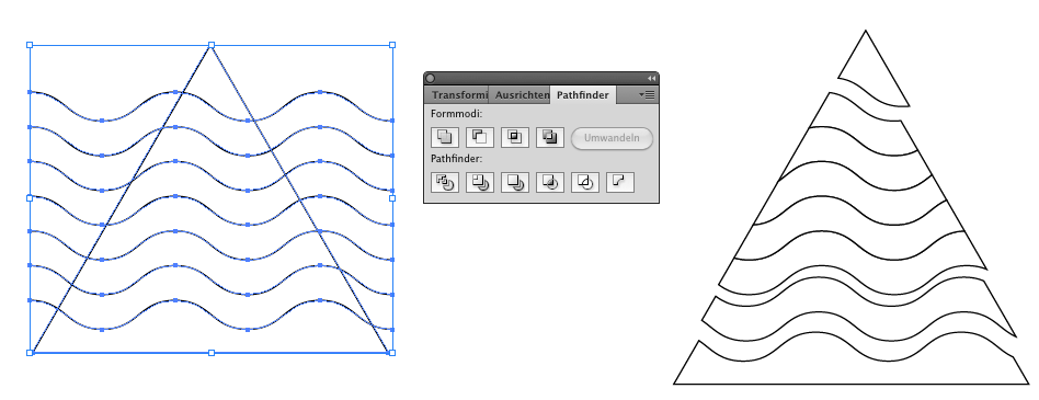

Monika Gause Jan 3, 2012 12:35 PM (in response to digiday)You can only use paths in an art brush, no pixels, no clipping mask.
So you need to re-create this in Illustrator. Should be fairly simple to create those wavy lines. Color them, use the pathfinder to create the triangle. Then you can create the art brush.
This here shows a slightly more complex procedure, because there's a gradient in it: http://www.vektorgarten.de/illustrator-flattening-transparency.html
For the wavy lines you can use the zigzag-effect (or the filter)

Monika Gause Jan 3, 2012 12:57 PM (in response to digiday)WHat you could try is to create shape layers in Photoshop. Then save this as a PSD and place in Illustrator. You have version 10 and I don't know if it is capable of doing this, but when embedding the PSD, Illustrator should ask you what to do with the PSD. Check: Convert Photoshop layers to objects.
When using the zigzag-effect (or filter), creating these waves should be much easier than doing the same in Photoshop, which doesn't have this kind of filter for vector paths. You only need one of these lines, then copy it a few times.

But now I have my newly created sine-wave color stripes and I'm trying to intersect those colors and paths with my trapizoid path to make it just a trapizoid filled with the color waves, but I'm not having any success with Object>Join, Average, Slice.
What am I forgetting?
Thanks,
digi
11. Re: Can I trim around a path on an imported bitmap layer?
digiday Jan 3, 2012 2:21 PM (in response to Monika Gause)Okay, I finally got it to slice by putting the trapizoid path above the wave paths and colors. But now when I select "New Brush", I don't have "Art Brush" available... it is grayed out.

14. Re: Can I trim around a path on an imported bitmap layer?
Monika Gause Jan 3, 2012 2:34 PM (in response to digiday)You need to select the whole graphic when creating the new brush. Then art brush should be available.
15. Re: Can I trim around a path on an imported bitmap layer?
digiday Jan 3, 2012 2:41 PM (in response to digiday)That did it!
